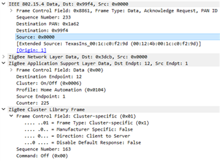

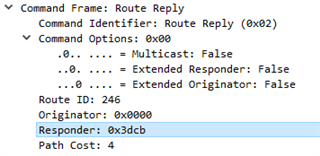

The coordinator requests a network path to the desired end device and receives a route reply response from the power outlet:
The coordinator sends a data packet (ZCL OnOff cluster command) to the end device, which is then successfully forwarded by the power outlet to the end device:

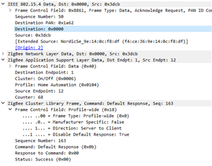

The end device sends back a confirmation of the receipt of data (default response), but sends it directly to the coordinator bypassing the routers despite the fact that it does not have a coordinator in the list of neighbors.
The coordinator is very far away and does not receive this data, but the end device does not attempt to send data through nearby routers. The end device simply repeats unsuccessful attempts to send data directly to the coordinator.
This situation is repeated constantly, it seems that the end device does not want to send data through routers at all.
