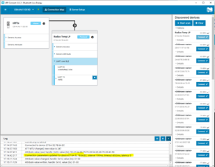

Hello I am using the nRF dongle combined with nRF Connect on my PC to connect to my BLE peripheral (custom board).  During connected state, I am seeing my average current consumption change when I connect to my iPhone versus the dongle.  When I connect using the dongle Iavg = 125uA, when I connect using my iPhone Iavg = 100uA.
Q1.  What is going on here?  Is the dongle changing connection parameters on my peripheral device?  If yes, how can I modify it so that it behaves identical to iPhone?

  • Hi.
    Sorry about the delayed response.
    Since it is the central that actually decides the connection parameters in a BLE connection, the phone will decide the connection interval. I don't believe that neither Android or iOS devices provides any API or any other way to change this. What the peripheral can do is to request other connection intervals, but the central can decide whether to accept it or reject it.
    The only thing the peripheral can do then is to disconnect (or accept the given connection interval).
