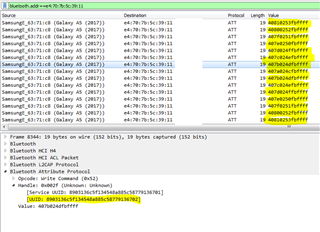

The screenshot below(nRF Connect App) and UUID is the information of the robot I want to control.
-Unknown Servie UUID :             8903136C-5F13-4548-A885-C58779136701
-Unknown Characteristic UUID : 8903136C-5F13-4548-A885-C58779136702
-Unknown Characteristic UUID : 8903136C-5F13-4548-A885-C58779136703
(As you can see, only the first BYTE value is different.)
And when analyzed with wireshark, the following results were obtained.
1) The screenshot above is when controlling the LED of the robot.
And the following UUID is used.
-service UUID : 8903136C-5F13-4548-A885-C58779136701
-UUID :              8903136C-5F13-4548-A885-C58779136703

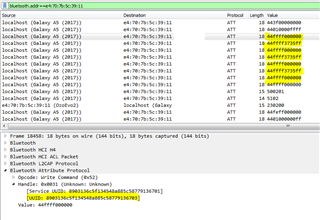

2) The screenshot above is when controlling the Motor of the robot.
-UUID :              8903136C-5F13-4548-A885-C58779136702
(If I try to control the motor and use the UUID required for LED control, I cannot control the motor.)
