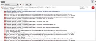

1.Hi I have changed the RX_PIN_NUMBER (8---->19) and TX_PIN_NUMBER(6----->20) in uart_init() function and connected these connections to my sensor and short GROUND too.Now when I run and start to debug the code I am receiving NRF_BREAKPOINT_COND in app_error_weak.c
2.Also uart_event_handle function will get called if sensor is sending the data OR I need to write anything for that
