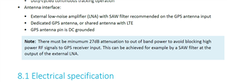

In the chapter 8 of the objective product specification of nRF9160 there is an antenna options list. Do I need to configure the antenna type that I’m using in my device and if yes, how to do this?

    Can you clarify what you mean by "configure the antenna type"?
    As for antenna I mean these note from the datasheet
     You should follow the guidelines in this document. It is recommended that you use a separate antenna for GPS and LTE.

  • You should follow the guidelines in this document. It is recommended that you use a separate antenna for GPS and LTE.
    Yes, we are using 2 different antennas for GPS and LTE.
