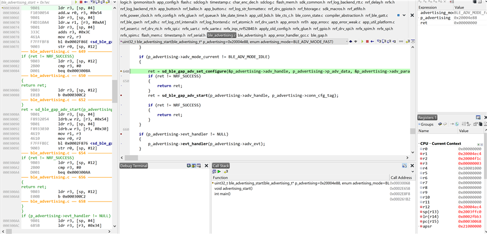

I'm using Soft device "s140_nrf52_6.0.0_softdevice.hex".
I tried debugging, it seems to be getting stuck at :
Edit: It actually gets stuck in the if statement on line 663 event handler
what can I do to resolve?
You mean in:
if (p_advertising->evt_handler != NULL)
p_advertising->evt_handler(p_advertising->adv_evt);
What does p_advertising->evt_handler point at?

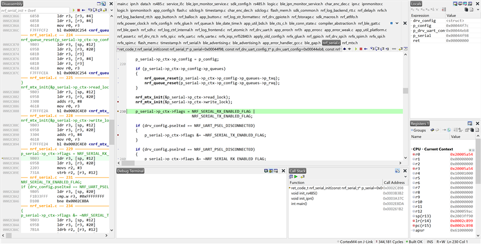

okay, I need to take back the posts.

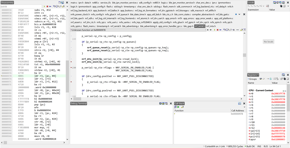

The code is actually not getting stuck in the soft device functions, It's getting stuck in nrf_drv_init().
I thought it was getting stuck on advertising, but then I added a breakpoint to the serial function. When I comment out the serial function, the code works fine.
The problem is, that I still cannot tell which function it's getting stuck at because the call stack is empty.
Please help,
thanks
So it asserts in the next step after line 230? Are you using the Softdevice? Note that there is a specific debug procedure for debugging with Softdevice.
