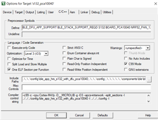

I even tried to build and load the heart rate sample source code to the nrf52 DK board, still did not work. But when i run the same heart rate code in debug mode (in Keil) i see the board advertise and able to connect from nRF Connect Application. As soon as i exit the debug mode the board stops working.
One more observation is, when i change the LFCLK to internal oscillator, i see advertisement for approx 1 sec and the device stops working, but the same works fine in debug mode again.
I wanted the board to be working with SDKv11 heart-rate source code to reuse most of my previous product design resources. Please help me to resolve this issue to continue our new product development work.
