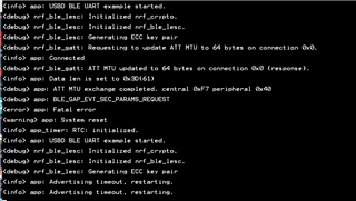

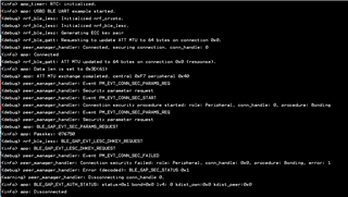

2. Add code to “usbd_ble_uart_pca10100_s113 – nrf52833_xxaa” project in “nRF5_SDK_16.0.0_98a08e2\examples\peripheral\usbd_ble_uart” from ble_app_gls project.
When the modified code is executed, an error occurs as shown below and reset.
How Fix it ??
Attach the modified code.
