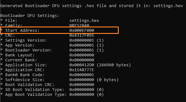

2. In the Bootloader sct file, the start address is 0xD6000, and the size is 0x1A000. But when I checked the hex file, the address ended at 0xE7000, while according the sct file, it ends at 0xF0000. The Bootloader settings location is at 0xEF000. Should I move it to be higher than 0xF0000?
    I am not sure bout this scatter (.sct) file you are referring to. Can you clarify? Which toolchain do you use, and what does it say? In any case, the bootloader location is simply at the end of the flash, but not overlapping the two last pages. It can start further down, but then you will wast flash at the end. The bootloader start address is programmed to the UICR and/or the last word in the MBR page (depending on SDK version), and that is part of the bootloader .hex. This lets the MBR know where the bootloader is located. See Memory layout for details.

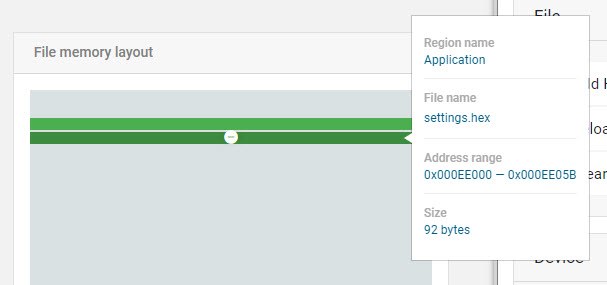

    We use the last address space, that's why everything became custom. The Bootloader shifted to 0xD6000, Bootloader settings was set at 0xEF000, and MBR Params at 0xEE000.

    • Program the bootloader. This will also program the bootloader start address to the UICR or the end of the MBR page (depending on SDK version), as that is part of the bootloader .hex file.
      • After doing this, the MBR will check and see that a bootloader is present, and will start it and enter DFU mode (unless the bootloader i knows that a valid application is present.
    • Generate and program a valid bootloader settings page. If you don't, the bootloader will not know that a valid application is present. If you do, and it is correctly generated, the bootloader will start the application (this is just half-true, see below for details*).
