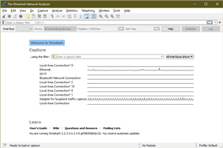

Wireshark doesn't see nrf51 dongle sniffer
The nRF sniffer is not listed in the Wireshark interface list.
Software versions: Windows 10 Pro 64 bit, Python 3.8, Wireshark 3.2.3, nRF Connect 3.3.3, Sniffer 3.0.0.
I programmed the dongle with hex image: sniffer_pca10031_129d2b3.hex. The toolbar shows up in Wireshark, but not the sniffer interface:
I tried the nrf_sniffer_ble.bat --extcap-interfaces command, and that seems to work fine.
Is there anything else I can try?
