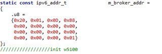

Thank your support.I use example in IoT mqtt to do this and try to find host_name but i dont see in library.Now i try to connect nrf52 dev board with W5100 first.After i will find the way to send data into MQTT.I will show it for you late.

You can set m_broker_addr to your mqtt server IP address. Please note that this is an IPv6 address format.
In function app_mqtt_connect(), you can see how mqtt is setup for client.
this mean i need config ipv6 and replace ipv6_addr_t???
Thankss
Yes.
