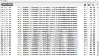

Measured RSSI = RSSI @ 1m. and it is -61dBm. (value taken from the beacon data)
Problem:
1.  what is measured RSSI and how can I judge it is -61dBm. because i measured the Beacon in DK1 and scanner code in DK2 . I received nearly -51 to -59 dBm . sometimes -63dBm.
