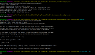

    Did you check that the library in SDK\external\openthread\project\nrf52840\plat_nrf527840\sdk-nodiag\armgcc\libopenthread-nrf52840-sdk-nodiag.a is present? If not, did you try to build it?
    One reason why it didn't build may be that you didn't import the correct commit. Remember to check what version that was used for the SDK in the file:
    SDK\external\openthread\readme.txt. For SDK for Thread and Zigbee 4.1.0, that would be:
    Then remember to run the script:
    SDK\external\openthread\project\build_gcc_libs.py
    before you call "py -3 import_libs.py gcc" (remember the gcc argument).
    If it still returns the same as you describe, what does it return if you manually try to build the library in nrf52840\plat_nrf52840\sdk-nodiag\armgcc (make the makefile)?
