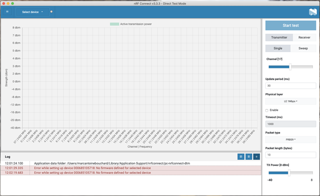

I'm try to test my nRF52833DK using the nRF connect Direst Test Mode. Even if I flash the DTM binaries in nRF5 SDK 16, the Direct Test Mode app says something like "No firmware available..."

Hi Marc,
Could you capture a screenshot of nRF Connect when you see the issue ?
I just tried to test here and it worked for me.
Could you try to test using the attached hex file ? Please use nrfjprog to program and do a reset after you program it.

Hi Marc,
Softdevice is not needed.
For some reasons now I am seeing the same issue as yours. I checked with the developer and the issue is that the NRF Connect DTM application couldn't detect the PCA10100 board, but it also didn't take the board as custom board, so it throw the error. We will add support for it in the next release of nRFConnect DTM.
