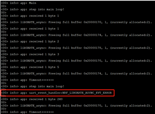

     I run my RX code in nrf52840DK, The first round of receiving 5Byte data is right(in fact, in each round the first Byte is for triggering gpio port event , I do not care its detail), But when the second round of data coming, it reports error. like this :

    If you toggle wakeup directly from the RXD pin, then the UART is in the process of receiving a byte when you init the libuarte library. This will cause a UART framing error -> NRF_LIBUARTE_ASYNC_EVT_TIMEROUT. I think this is expected based on the description, you can ignore the error.
    You can also try to add a delay of 100ms when if(myGPIOTE_EVENT_FLAG) is true, then you know there is no more UART activity when you init libuarte.

           I think you may not get my issue, thanks for the three suggestions you provided, I gave some explanations here based on my Rx code:
          1. The first byte from Tx is to wake up the the RxD pin, so the RxD pin SENSE the signal as an gpiote port event, then in the gpiote event interrupt I added a delay like: "for(int i=0;i<50;i++);", so it's not the problem;
          Because Rx cannot know when to close the libuarte and step into idle mode(with gpio SENSE),I added the new event                  NRF_LIBUARTE_ASYNC_EVT_TIMEROUT to inform the main loop that : there is a time that TX not sending data and it's time to stop libuarte.
          2.it's OK to received correctly data in the first round, the error is in the second round, the RX program running like this:
          system_idle1->gpiote port event->uninit gpiote, init libuarte->received all data correctly->(because Tx sent all the data and started long delay) Rx timeout, so uninit libuarte->reinit gpiote->system_idle2; then untill the second round data coming:
         -> gpiote port event->un-init gpiote, init libuarte-> NRF_LIBUARTE_ASYNC_EVT_ERROR
         So in my loop, system_idle2 seems to not completely the same with system_idle1, thus cause the  NRF_LIBUARTE_ASYNC_EVT_ERROR event.
         3.I will try your method, in fact I already had an simplified test case(only with uart+gpiote+app_timer). it can work not needing to reset the peripheral, it's possible to work without resetting peripherals.

  • Hi Kenneth
        I tried to reset the uarte used by the libuarte library after uninit , then the event"
    NRF_LIBUARTE_DRV_EVT_RX_DATA" will never come , I just can receive the last byte from timeout event...
    Smile
    BR
  • Can you toggle a GPIO when you call nrf_libuarte_async_enable() so you can monitor on a logic analyzer to make sure that no UART byte is in the middle of a transaction when you enable it?
    Also, instead of modifying libuarte, have you considered starting an app_timer in application to handle if no data is received on UART after nrf_libuarte_async_enable?
    The timeout in libuarte is used to detect inactivity on the UART lines (e.g. no more data received since last byte), the timeout will likely not start unless it first receive a byte.
    Kenneth
  • Hi  Kenneth
         I think the problemed solved, I just tried to reset uarte0, then the whole round always works~~, think you.
