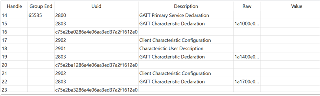

  • Hello, order refers to handle number in attribute table. Please see attached picture.
    For characteristic with handle 16, 2902 has handle 17 and 2901 has handle 18. I want to swap their order, so 2901 has handle 17 and 2902 has handle 18.
    Below is my code creating this characteristic, is there any place I could change their order in initialization? Thanks

  • The handles are just assigned in the order they are created. Since the CCCD is created first, it will be assigned first. This is done inside the softdevice, so it is not possible to change, unfortunately.
    I have not seen this request before, but I guess it shouldn't be a problem. Why is it an issue that the CCCD handle has a lower handle value than the user description? Seeing as the handles are randomly assigned depending on how many services and characteristics you have, the natural approach would be to use the UUIDs that are fixed (according to the BLE specification).
