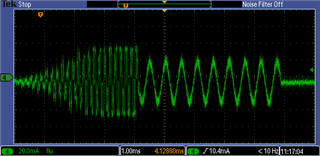

I am developing a device using  Arduino Nano-33-ble board which is based on the nRF52840.
The  code is developed on Arduino IDE and the basic function is to generate  bursts of Sinusoidal wave through I2S via a audio amplifier IC (MAX98357A).
Since I couldn't find support for nRF52 I2S peripheral in the arduino libraries,  I am using the nRF SDK HAL functions as defined in the nRF header files available in the arduino library.   Please find attached the source code that we have developed so far.  The code generates a burst of Sine waves by sending data from a buffer through I2S using DMA.
The issue I am facing is that the  wave output of the  MAX98357A is giving some noise at the start of each burst signal.
The problems identified :
DMA works in  continuous mode only, it doesn't stop  after the i2s transfer completion.
There is no completion callback for  i2s transfer. TXPTRUPD event occurs only when the data  is copied to the internal hardware buffer.
Can you please help me to reduce this noise seen at the output of codec?
Is there any option to know when the easy dma transmission is completed?
This noise is high when frequency of sine wave reduced.
Kindly refer the attached wave form obtained .

    jesse wilson said:
    1)Can I configure Easy DMA in such a way that DMA transfer is stopped when NRF_I2S->TXD.MAXCNT bytes of data transmission is completed?
     Yes, you can use PPI to connect the EVENTS_TXPTRUPD event (which will be generated for every RXTXD.MAXNT words that are sent on the SDOUT pin) with TASKS_STOP on the I2S peripheral. Usually you need to trigger the TASKS_START again afterwards.
    jesse wilson said:
    2)Are there any interrupts generated at the completion of Easy DMA transfer? can we configure this?
    You can use the EVENTS_TXPTRUPD event to set an interrupt.
