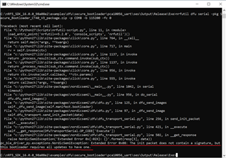

DUF of Bootloader
Now I am trying to do the same for generating Bootloader package. Generate Bootloader DFU package
nrfutil pkg generate --hw-version 52 --bootloader-version 3 --bootloader secure_bootloader_uart_mbr_pca10056.hex --sd-req 0xCA --key-file private.key Secure_Bootloader_V3_package.zip
I am trying to do Bootloader DFU using below commands.
nrfutil dfu serial -pkg Secure_Bootloader_V3_package.zip -p COM8 -b 115200 -fc 0
But Bootloader DFU is not success. Below is the snapshot.
But I am able to do DFU of my application.
1) Is there any issue in generating boot-loader DFU package and loading.
2) As per below link I used version 3 as, already loaded bootloader version is 2. In bootloader code is there any version macro where I need to change to 3.
https://infocenter.nordicsemi.com/index.jsp?topic=%2Fsdk_nrf5_v16.0.0%2Flib_bootloader_dfu_validation.html&anchor=lib_dfu_image
But above macro NRF_DFU_APP_DOWNGRADE_PREVENTION I am seeing “This does not apply the bootloader updates.” I am bit confused. Whether bootloader version should always be greater.

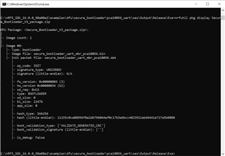

    1. It looks good to me. Can you check the DFU image with "nrfutil pkg display <zip>"? What does it say? If that does not provide any hints, then  I wonder if you are testing on a DK or custom HW? If you are testing on a DK, then it could be good to disable the mass storage device feature of the onboard debugger as that could cause UART data corruption.
    2. Yes, the version number should be increasing.
    Einar
    1) Please find snapshot "nrfutil pkg display"
    2) Yes, I am trying on nRF Development kit. To disable mass storage do you mean "Disabling the Mass Storage Device functionality". Will cause any problem after disabling. Is there a way to enable Mass storage in future.
    This shows a package withoug signature. Did you get this using the following command (from your initial question)?
    Fullscreen
    1
    XXXXXXXXXXXXXXXXXXXXXXXXXXXXXXXXXXXXXXXXXXXXXXXXXX
    The command looks OK, and when I copy-paste it and test I get a correctly signed DFU image. Can you double-check? If this command really did produce an unsigned image it would be interesting to know the exact nrfutil version you are using ("nrfutil version").

    1) Yes, I used same command to generate bootloader package. You mentioned unsigned. Is this based on "signature_type: UNSIGNED" in snapshot ?
    2) Below is the verion of nrfutil
    3) I deleted existing package and regenerated. After that its shown as "signature_type: ECDSA_P256_SHA256" and able to do DFU of bootloader. But I am not sure why it was creating issue with previous package.
    Thanks & Regards
    Vishnu Beema
  • Hi Vishnu,
    Yes, that is what I mean. You will get this if you don't specify a key, by omitting the --key-file option. In this case, the DFU package can only be used with bootloaders that don't require signed updates. If you do, nrfutil also prints the following warning:

    I am not aware of any other way to generate DFU packages without a signature.
    nrfutil version 5.2 should be OK. I have not found any references to issues with signing packages like this in that or other versions.
    It is good that it works now. Could it be that you just forgot the --key-file option when you generated the package initially, and now you remembered it?
