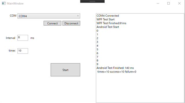

I tried to see how much data I could communicate and at what speed. So, I made it possible to increment and send numbers at regular intervals from my own serial monitor and Android app(Android-nRF-UART).
I experimented in the following way.
  1. The sample "ble_app_uart" of SDKv16.00 was written in nRF52832.
  2.  I installed "Android-nRF-UART (slightly edited)" on my Android tablet (Android 7.0) using Android studio.
  3. Windows PC via uart and monitor it with a serial monitor of my own making.
First, we tested the communication from the serial monitor to the Android app.(serial monitor -> Android app)

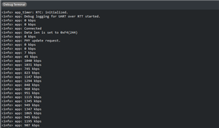

    I tried it with the file you attached (I only had Android).
    The result was about 26~30 kbps. Android-nRF-UART, Android-nRF-ToolBox, and my own application all had similar results.
    Sorry, I looked over the project again and see that I had configured NRF_SDH_BLE_GAP_DATA_LENGTH to 27 instead of 251. I had also kept the default NRF_SDH_BLE_GAP_EVENT_LENGTH setting. Both of these will have a significant impact on the transfer speed given that the phone you are connected to support the same configuration.
    Please try the attached configuration and see if you can get closer to the numbers listed in the Softdevice specification.
    New configuration tested with Google Pixel 2 running Android 10:
    pca10040_throughput_fix.zip
  • Hi, Vidar Berg
    Thank you for your quick reply.
    I tried it with the attached settings. In my environment, it was about 80~100 kbps. Overall, it's now up to 72 kbps, which is much faster than before.
