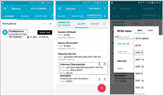

1) After clicking Connect, device got connected. Then I selected “Pair…” with “IO Capability” as “No Keyboard, no display”. Now I am able to write/read. But once “Connection parameters updated for device” I am getting BLE_HCI_CONNECTION_TIMEOUT after 13sec. I am not sure the reason behind this.
a) Even I selected “Update connection…” and gave parameters as Interval 1 sec, Latency 5 and Timeout 13 s but still same issue.
2) Similar to nRF Mobile app how to see RAW data of Advertisement packet in nRF Desktop connect tool.
3) Using nRF Connect app, I am able to select type of data. But how to do the same in nRF Connect desktop tool. I am not seeing such options.

    With NRF_SDH_CLOCK_LF_SRC set to 1 and NRF_SDH_CLOCK_LF_ACCURACY to 1 now its working fine. Can you please clarify my above queries. For easy tracking, I updated once again.
    1) With my settings it was working well with nRF Connect mobile app. With the changes you mention, will there be any impact on timing issues and Current consumption. Any reason why it is working with nRF Android app but not with nRF Connect Desktop tool.
    2) Even we want to work with Static passkey. With Android app we are give passkey as input. With nRF Desktop tool what are the options to give passkey.
    3) Similar to nRF Mobile app how to see RAW data of Advertisement packet in nRF Desktop connect tool.
    4) Using nRF Connect app, I am able to select type of data. But how to do the same in nRF Connect desktop tool. I am not seeing such options.
    5) Just a correction. For Latency there is no units. In below its showing as 5 ms when I configure Latency as 5.

    1) What is the ppm accuracy of your LF crystal ? Maybe it was set too low.
    2) Passkey should be supported on nRF Connect Desktop app also.
    3) nRF Connect Desktop parses the data for you. Raw format is not shown.
    4) No support for different data type. Only hex values.
    5) Yes, this seems to be a bug. "ms" should be removed.
