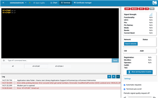

I am trying to update the nRF9160 device because I can't get a network connection.
I followed the guidance of a manual of this site (https://devzone.nordicsemi.com/nordic/cellular-iot-guides/b/getting-started-cellular/posts/nrf-cloud-certificate-update).
When it comes to the point " ensure the modem is in offline state (AT+CFUN=4)" I get a timed out Error.
I attached a screenshot which shows the error and also that I have added the "nrf91dk_at_client_long_at_commands" which should prevent it, but didn't helped.
Hope you can help me with something I can try to make it work.
Thanks in Advance and best
greetings
jseidel

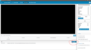

  •  Did you remove the SIM card and uncheck "Automatic requests" in the LTE Link Monitor? Did you get any errors?!
    I've done that and didn't got any errors.

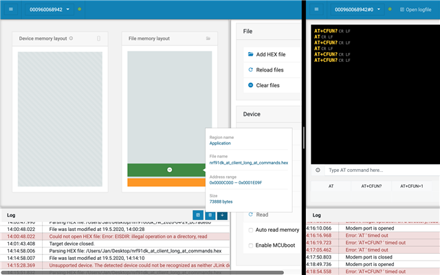

    In the LTE Link Monitor I get two kind of errors, but independent of those changes:
    - Error while probing devices: Error occured when get serial numbers. Errorcode: CouldNotCallFunction (0x9) Lowlevel error: INVALID_OPERATION (fffffffe)
    -> after starting the software
    and
    - Error: timed out after every at command I try.
    Did you get any errors while programming this?
    No I can easily add it in with drag & drop.

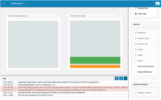

    In the programming software I get the error 'Unsupported device. The detected device could not be recognized as neither JLink device nor Nordic USB device.'
    That's why I can update the firmware of the device and so not the certificates in the lte link monitor.

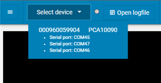

  • Thank you! Unfortunately, this is the board controller output. At least we have confirmed that it works as intended. Please try with another port, or check the "Auto device/port filter"
    This should give the following view in the "select device" menu:
  • Alright I have checked the 'Auto device' box, but still have several ports to choose.
    Where can I find the LTE Link Monitor output you need?
    What else can I do?
    Thanks and regards.
  • I'm sorry if I was unclear, your settings should look exactly like the image I provided.

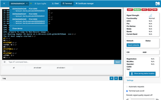

  • I'm sorry, this is still the output from the nRF52840. You will need to check "Auto device/port filter", as mentioned here, and then "Select device".
    This will automatically select the correct COM port for you to give the correct output.
