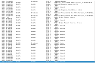

I have been studying the power consumption of a prototype and observe that the end device is polling very frequently.
The data request polling is backing off for a while to about every 3 seconds, but suddenly (efter 15 seconds or so) the device starts polling every 200 ms or so.
If I disable the turbo polling mode then the polling will be every 500ms from start.
I'm wondering if you can help me put with some pointers to there I should start looking.
My goal is to poll once every ten seconds or so, and maybe a increased polling rate after any device activity to fetch pending commands.
My project is based on the multiprotocol doorlock example in sdk 4.0.0 and I am using SDK 16.0 to fill in the gaps to make it compile. Changes that I have meade includes moving the application out of the sdk-directory structure and I am using make and gcc to build it.
A log from wireshark:

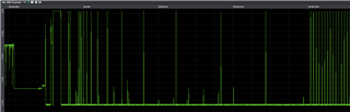

Power measurement:

    What I see after bootup and joined network is a few "turbo polls" with increasing data request intervals. but after 15 seconds the interval is set to 200ms and thus consuming a lot of battery.
    If I call zb_zdo_pim_set_long_poll_interval manually then it will take immediate effect but I do not know how to do it in a good way without guessing with timers.
