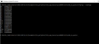

  • i don't know if the GSM module is necessary i didn't check without it, i do know that  when it calls task_switch it gets hard fault for memory region 0x00000, yes it's a hard fault i got the hardfault module from the sdk compiled in and i checked the registers state when i got the breakpoint, it was definatly not an assert, what's more all the asserts are BEFORE the call to task_switch and the exception according to LR happens AFTER the return from the function.
