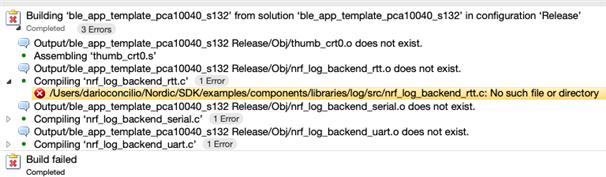

nrf52-ble-tutorial-advertising error cannot find a file during compiling
Dario Concilio
over 6 years ago
Why it searches component folder under examples?!?

Try the following:
Download SDK 15.0.0
Open command line in
<..>\nRF5_SDK_15.0.0_a53641a\examples
and run:
git clone
https://github.com/NordicPlayground/nrf51-ble-tutorial-advertising.git
Open examples\nrf51-ble-tutorial-advertising\nrf52-ble-tutorial-advertising\pca10040\s132\ses\ble_app_template_pca10040_s132.emProject and build the project
