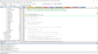

.\_build\nrf52832_xxaa.axf: Error: L6218E: Undefined symbol nrf_twi_mngr_init (referred from main.o)
Dear all,
Im trying to interface LIS3DH with the following code, and drivers of LIS2DH (LIS3DH and LIS2DH have the almost same hardware and config.)

I have included the external drivers for nrf manager, twi_manager and sensor related drivers also, as in below images
The Configuration wizard settings are as below.
But im getting following error.
Kindly help me solve this issue. How to enable the twi manager and resolve this issue.
    Did you include the file that contains the missing error? (I can't see which one it is, since the uploaded picture was too small (it happens some times).
    If you already included the file, the issue is probably related to the defines in sdk_config.h. Please check the file apply_old_config.h to see how the "legacy" definitions overrules the nrfx definitions. Just try to set the same legacy definitions as your nrfx definitions for the TWI in sdk_config.h.
    Edvin
  • The errors are in the functions present within the file of TWI manager. As you can see in the images mentioned in the question, the files are included. But the  nrf_twi_mngr.c file is disabled(as below)
    the apply_old_config.h, looks as below . Can you give instructions in more details as to how to resolve this.
    the complete code of apply_old_config.h file is as below

  • the error vanishes, but the twi manager is not enabled. May i know the reason why?
