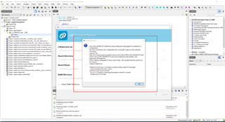

1.You provide this routine to compile the error:
The error is as follows:
2. There are two configuration routines available at the bottom:
