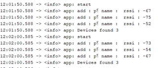

Read Device name, address and RSSI
I am trying to find RSSI of the value of the nearest device also I need the  Device name, address of those devices. I got the RSSI value but some problem in Device name, address.
I attached the log

/**@brief Function for printing the devices.
 *@details Function print list of devices.
 * @param[in] device      Pointer to the struct storing the scanned devices.
static void device_list_print(scanned_device_t * p_device)
NRF_LOG_INFO("start");
  for (uint8_t i = 0; i < DEVICE_TO_FIND_MAX; i++)
      if (p_device[i].is_not_empty)
         char buffer[ADDR_STRING_LEN];
          int_addr_to_hex_str(buffer, BLE_GAP_ADDR_LEN, p_device[i].addr);
          NRF_LOG_INFO("add : %s name : %s rssi : %d", buffer,  p_device[i].dev_name, p_device[i].rssi);
//      NRF_LOG_INFO("name : %s", m_device[i].dev_name);
    NRF_LOG_INFO("Devices found %d", device_number);
    // We could now clear the list:
    //scan_device_info_clear();
scanned_device_t * scan_device_info_get(void)
    return m_device;
typedef struct
    uint8_t * p_data;   /**< Pointer to data. */
    uint16_t  data_len; /**< Length of data. */
} data_t;
static void device_to_list_add(ble_gap_evt_adv_report_t const * p_adv_report)
    uint8_t  idx             = 0;
    uint16_t dev_name_offset = 0;
    uint16_t field_len;
    data_t   adv_data;
    // Initialize advertisement report for parsing
    adv_data.p_data   = (uint8_t *)p_adv_report->data.p_data;
    adv_data.data_len = p_adv_report->data.len;
    for ( idx = 0; idx < DEVICE_TO_FIND_MAX; idx++)
        // If address is duplicated, then return.
        if (memcmp(p_adv_report->peer_addr.addr,
                   m_device[idx].addr,
                   sizeof(p_adv_report->peer_addr.addr)) == 0)
            return;
    // Device is not in the list.
    for (idx = 0; idx < DEVICE_TO_FIND_MAX; idx++)
    if (!m_device[idx].is_not_empty)
            memcpy(m_device[idx].addr,
                    sizeof(p_adv_report->peer_addr.addr));
            m_device[idx].rssi = p_adv_report->rssi;
            m_device[idx].is_not_empty = true;
            device_number = device_number +1;
            // Search for advertising names.
            field_len = ble_advdata_search(adv_data.p_data,
                                           adv_data.data_len,
                                           &dev_name_offset,
                                           BLE_GAP_AD_TYPE_COMPLETE_LOCAL_NAME);
            if (field_len == 0)
                                               adv_data.data_len,
                                               &dev_name_offset,
                                               BLE_GAP_AD_TYPE_SHORT_LOCAL_NAME);
                // If name is not found, then return.
                if (field_len == 0)
                    return;
            memcpy(m_device[idx].dev_name, &adv_data.p_data[dev_name_offset], field_len);
            m_device[idx].dev_name[field_len] = 0;
            //NRF_LOG_INFO("name : %s", m_device[idx].dev_name);
            return;

/**@brief Function for handling Scaning events.
 * @param[in]   p_scan_evt   Scanning event.
static void scan_evt_handler(scan_evt_t const * p_scan_evt)
    ret_code_t err_code;
    switch(p_scan_evt->scan_evt_id)
        case NRF_BLE_SCAN_EVT_CONNECTING_ERROR:
            err_code = p_scan_evt->params.connecting_err.err_code;
         case NRF_BLE_SCAN_EVT_NOT_FOUND:
             device_to_list_add(p_scan_evt->params.p_not_found);
        default:
/**@brief Function for initializing the log.
static void log_init(void)
/**@brief Function for handling the list_timer event,
static void adv_list_timer_handle(void * p_context)
    //Print devices
    scanned_device_t * p_device_list = scan_device_info_get();
    device_list_print(p_device_list);
/**@brief Function for initializing the timer.
static void timer_init(void)
    // Timer for refreshing scanned devices data.
    APP_TIMER_DEF(adv_list_timer);
    err_code = app_timer_create(&adv_list_timer, APP_TIMER_MODE_REPEATED, adv_list_timer_handle);
    err_code = app_timer_start(adv_list_timer, FOUND_DEVICE_REFRESH_TIME, NULL);
