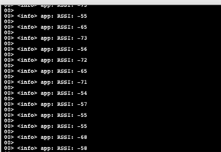

  • I used BLE central multilink example to scan for beacons using 16bit service UUID.
    I can scan for beacons device without forming any connection between them. But I am not able to differentiate the RSSI values coming from 4 beacons.
    Is there any event in scan_evt_handler that I will give me RSSI values of each beacons? or any other solution would you like to suggest?
    I just want to get RSSI values of each and every beacons present in the room.

    and inside My scan_evt handler function, I used NRF_SCAN_EVT_FILTER_MATCH event to get the RSSI values.
    case NRF_BLE_SCAN_EVT_FILTER_MATCH:
              int rssi_value = p_scan_evt->params.filter_match.p_adv_report->rssi;
                NRF_LOG_INFO("RSSI: %d", rssi_value);

    From looking at the code you have provided, your general approach seems correct.
    Could you elaborate on what you are seeing - what happens when you run this code with a nearby beacon? What outputs do you get, and how does it differ from what you had expected?
    For example, are you not seeing the last NRF_LOG_INFO statement, with RSSI value? Could it then be that you are never getting a filter match in the first place? If so, what other scan events are you getting instead?
    To check if your filtering is the problem, you can disable it and see if you are able to receive the RSSI of unfiltered advertisements. Then you may begin to filter the different sources.
    As a side note, you might also want to log the major and minor of the beacon the RSSI came from, to differentiate between the different ones.

    This is what I can see after running the script.
    I just want to differentiate the RSSI values according to each and every beacon.
    Right now, after filtering I am getting the RSSI values but I am not able to differentiate RSSI values.
    I want something like
    Beacon-1 RSSI- -53dbm
    Beacon - 2 RSSI - 50dbm etc
    Just let me know how we can differentiate the RSSI using minor and major values of beacons.

    Great! I am glad you were able to retrieve the RSSI values.
    You could change the major/minor value of each beacon, and then differentiate by their values.
    Alternatively, you may differentiate their peer address, which is available if you are not broadcasting as anonymous.
