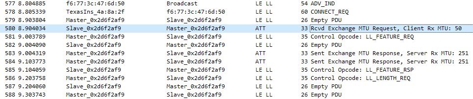

When the macro NRF_SDH_BLE_GATT_MAX_MTU_SIZE is changed in the sdk_config.h file of any example from the ble_peripheral folder, the slave sends the message Exchange MTU Request (ATT_EXCHANGE_MTU_REQ) immediately after the connect event.
Is it correct?
As I understand, the ATT_EXCHANGE_MTU_REQ request shall only be sent once during a connection by the ATT client (the master).
Am I missing something?

    It seems you do not understand my question. I will try to explain in steps:
    - select for example BLE Blinky Application (<InstallFolder>\examples\ble_peripheral\ble_app_blinky);
    - increase NRF_SDH_BLE_GATT_MAX_MTU_SIZE in sdk_config.h:
    #define NRF_SDH_BLE_GATT_MAX_MTU_SIZE 50;
    - build and run example;
    - establish BLE connection.
    The roles of the BLE Blinky Application in this connection are:
    - LL slave
    - GAP peripheral
    - GATT server
    So the question is the same: Why does the GATT server (BLE Blinky Application) send an ATT_EXCHANGE_MTU_REQ request at all?

    The spec. indicates that MTU exchange is only used by the Client, but the paragraph does not explicitly prohibit the server from doing the same. BT spec is usually not this vague in its description. Both Central and Peripheral devices can issue an MTU exchange request, regardless of the GATT role. Our SoftDevice will handle the request so as to be in accordance with BT spec.  Please see this similar question.

  • In my opinion, your interpretation of the "The ATT_EXCHANGE_MTU_REQ PDU is used by the client to inform the server" as "the paragraph does not explicitly prohibit the server from doing the same" is very controversial.
    Because:
    1. The ATT_EXCHANGE_MTU_REQ PDU has "Client Rx MTU" parameter, not "Rx MTU" or "Server Rx MTU";
    2. If the GATT server sends the MTU request, it may cause problems:
    - with Windows 10, see this message
    - with Linux (Python + BluePY + Bluez), see this thread
    So, in my opinion, the modifying on_connected_evt() function in nrf_ble_gatt.c like in this message is not a good alternative. A preprocessor macro or other choice for a programmer would be better.
