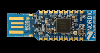

for example, to communicate a system designed with the nRF52832 with a laptop without bluetooth, I need some device that allows communication. My question is which device to use?
The device is in this link: http://www.arenabit.com.br/adaptador-bluetooth-4-0-dongle-usb-p1884
I suggest you look for a dongle that supports Bluetooth 4.2 or later. Anything less is not recommended. It best to find one with Bluetooth 5. Better yet, buy a new laptop, they all have Bluetooth LE builtin. A laptop without builtin Bluetooth LE is too old already.
ok Nguyen, thanks a lot.
There's always the nRF5284 dongle:
https://www.nordicsemi.com/Software-and-tools/Development-Kits/nRF52840-Dongle
