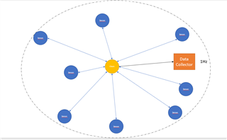

I would like to create a mesh application with different nodes that are gyroscopic and pressure sensor in a 10+-  meters radius area and provide the data from the sensors node to a Raspberry collector at 1Hz.
Im using Several NRF52832 Devloppement Board, SDK 16.0 and  SDK Mesh 4.0

4) IS it better to create mutliple server node and one client node OR Control model ( both server and client ) acordingly to mesh spec. ?

    4) In Bluetooth mesh, the state (such as sensor readings) exist in a server model. The state can be set or read from a client model. That means if you have a mesh node who is also a sensor, that node would typically have a sensor server model. It can periodically publish status messages containing the current sensor value. The node receiving the sensor models will be a client. A control model, on the other hand, is a model that acts both as client (to some nodes) and server (to some nodes). Typically a control model performs complex calculations such as regulating heating in a room based on sensor readings from thermometers, occupancy senosors, time of day, etc. If you do not need any nodes that do that kind of decisions and control, then you do not need any control models. If all you need is to relay data, then you should address messages directly from the sensors to the device collecting the sensor data. (Messages will get resent through the network and arrive at the collecting device.)

    About 4) If all the server are linked directly to one device won't there be any synchronisation problem ?
    I am not sure if I 100% understand what you mean, but:
    • The network topology is not using direct links, rather messages are automatically resent through the network until they reach the destination. There is no active synchronization, but throughput is throttled to prevent congestion.
    • If multiple elements publish to the same group address, elements subscribed to that group address can see which element sent the message from the source address of the message.
    Terje
