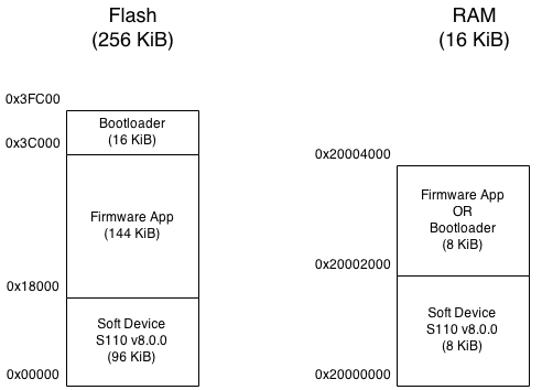

I need to know where and how much memory to allocate for the S110 Soft Device v8.0.0, the DFU Bootloader, and a firmware app. These all aren't playing nicely together with the device memory.
What I believe/want to be true:
image description
Does the Soft Device really need 8 KiB of RAM?

Problem 1. I run out of space when I go to compile and have to reduce my stack usage to 255 B (see this post). I have no idea whether this is safe, or whether it is likely that I'll overflow the stack. Is the assembly in arm_startup_nrf51.s the linker?
Problem 2. When I try to reduce the IRAM1 Start to 0x20002000 and add 0xC00 to the size field, I get alerts in the mobile app along the lines of Error on Receive Firmware Image Message: Operation Failed). This partially stems from my ignorance to the difference between IRAM1 and IRAM2.
Does anyone have settings that will work well together for the nRF51822_xxAA variant and the new S110 SD - v8.0.0? I'm not sure if it makes a difference, but this is currently using silicon revision 2.
