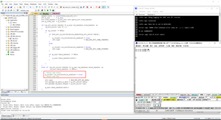

    The log says that in your main.c file there is an APP_ERROR_CHECK(err_code); with err_code = 0x3401 (=13313).
    Can you check what function call that is? Remember to debug into the functions to see what call inside that function that returned 0x3401.
    0x3401 is BLE_ERROR_GATTS_SYS_ATTR_MISSING (defined in ble_gatts.h).
    This is usually returned if you try to send a notification, but notifications aren't enabled. Did you enable notifications before calling ble_nus_data_send()?
    What does your ble_evt_handler() look like?
    Do you handle the event: BLE_GATTS_EVT_SYS_ATTR_MISSING? If so, what do you do in that event?

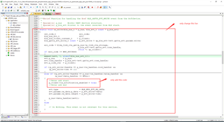

  • Hello
    I just modified the code for the red box section.
    The other code is the default routine
    Kind regards. Peter.Min
  • That doesn't tell me much. What function is this? Does the issue happen if you remove the change in the red box? Are you trying to force the notification to turn on from the peripheral? You can't do that because of two reasons:
    1: It is against the BLE specification.
    2: The softdevice will not allow that.

  • 1.APP_ERROR_CHECK(err_code); err_code = 0x3401(= 13313)The corresponding function is:
    2.
    The notification code function is enabled for:
    static void on_write (ble_nus_t s p_nus, ble_evt_t const s p_ble_evt)
    The criteria for judging are:
    else if (p_evt_write-handle- s-p_nus-rx_handles.value_handle)
    (p_nus-data_handler!
    The enable method is:
    p_client-is_notification_enabled -true;
    3.This event was not handled:
    This event sdk defaults to:
    No system attributes have had has stored.
    err_code s sd_ble_gatts_sys_attr_set (m_conn_handle, NULL, 0, 0);
    APP_ERROR_CHECK (err_code);

    1. In order to enable cccd in nrf52532, I modified the routine:
    Project.nRF5_SDK_15.nRF5_SDK_15.0_59ac345?ble_peripheral?ble_app_uart?pca10040?s132-arm5_no_packs ble_app_uart_pca10040_s132.uvprojx
    2. In the ble_app_uart routine I made the following modifications:
    6.
    Although I know that forced enable CCDCs in ble_peripheral do not meet the Bluetooth specification,
    But I still want to force the ability to make a cccd ble_peripheral here.
    My previously modified code does nuns that do not enforce the ability to make CCCD.
    Please help me complete an example that can be forced to enable CCCD.
     Sorry. It doesn't work this way. The actual CCCD is stored in the softdevice, and you can't force it. The one that you try to force is just a copy of that flag which is used for the application layer logic. No way to force it from the peripheral.
    You need to enable notifications from your central application.
