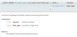

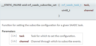

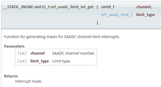

    4. can using this function
    and this
    or this
    help to configure an event for each channel ?
    I would not recommend mixing HAL and driver function calls in your application, since this may unintentionally put the driver into an invalid state. What happens when you build and run the code you included above?
