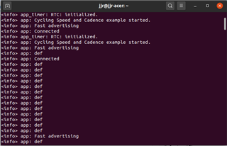

I'm getting err_code BLE_CONN_HANDLE_INVALID after calling ble_cps_measurement_send
I thought ble_cps_on_ble_evt was handling all of this but seems not.
I tried adding  this line :
    NRF_SDH_BLE_OBSERVER(m_cps_obs, APP_BLE_OBSERVER_PRIO, ble_cps_on_ble_evt,  &m_cps);
 in ble_stack_init() but it didn't work
I tried passing the connection handler in the ble_evt_handler but now it wont advertise
    ret_code_t err_code = NRF_SUCCESS;
        case BLE_GAP_EVT_CONNECTED:
            NRF_LOG_INFO("Connected");
            m_cps.conn_handle = m_conn_handle;
And so many other things which all doesn't work...
Looking for help

    I can't find ble_cps_measurement_send() in our SDK. Is this a custom function? If not, what SDK are you using?
    Did you test the unmodified ble_app_rscs example? Does it behave the same?
  • Hello, yes, ble_cps_measurement_send() is a custon function. I'm using SDK 160098a08e2 with softdevice s132.
    Running the unmodified ble_app_cscs example runs perfectly.
    I have included ble_cp.h and ble_cp.c if you want to reproduce the error.
    Thank you very much Edvin.

    Unfortunately it didnt fix the issue but now the error code I get at ble_cps_measurement_send() is
    NRF_ERROR_INVALID_STATE
  • That means that you have not enabled notifications from your central yet. Try to do this. If you call ble_cps_measurement_send() before notifications are enabled from the central, you can ignore the return value NRF_ERROR_INVALID_STATE from ble_cps_measurement_send().
    err_code = ble_cps_measurement_send()
