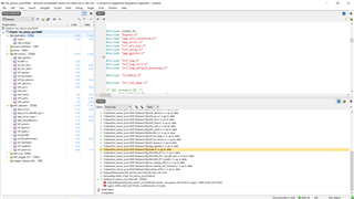

Output/Release/Exe/twi_sensor_pca10040.elf section `.nrf_queue' will not fit in region `UNPLACED_SECTIONS'
Im trying load a TWI sensor custom built with LIS3DH, and it is showing following error.
Building ‘twi_sensor_pca10040’ from solution ‘twi_sensor_pca10040’ in configuration ‘Release’

  Output/Release/Exe/twi_sensor_pca10040.elf does not exist.
  Generating linker script ‘twi_sensor_pca10040.ld’
  Linking twi_sensor_pca10040.elf
    region `UNPLACED_SECTIONS' overflowed by 20 bytes
Build failed
The xml file looks as below

Can you kindly guide me, how to resolve this?
    The problem is that the .nrf_queue section is not defined in your flash placement file. Please try to rebuild with the flash_placement.xml attached below.
    <!DOCTYPE Linker_Placement_File>
    <Root name="Flash Section Placement">
      <MemorySegment name="FLASH" start="$(FLASH_PH_START)" size="$(FLASH_PH_SIZE)">
        <ProgramSection alignment="0x100" load="Yes" name=".vectors" start="$(FLASH_START)" />
        <ProgramSection alignment="4" load="Yes" name=".init" />
        <ProgramSection alignment="4" load="Yes" name=".init_rodata" />
        <ProgramSection alignment="4" load="Yes" name=".text" />
        <ProgramSection alignment="4" keep="Yes" load="Yes" name=".pwr_mgmt_data" inputsections="*(SORT(.pwr_mgmt_data*))" address_symbol="__start_pwr_mgmt_data" end_symbol="__stop_pwr_mgmt_data" />
        <ProgramSection alignment="4" keep="Yes" load="Yes" name=".nrf_queue" inputsections="*(.nrf_queue*)" address_symbol="__start_nrf_queue" end_symbol="__stop_nrf_queue" />
