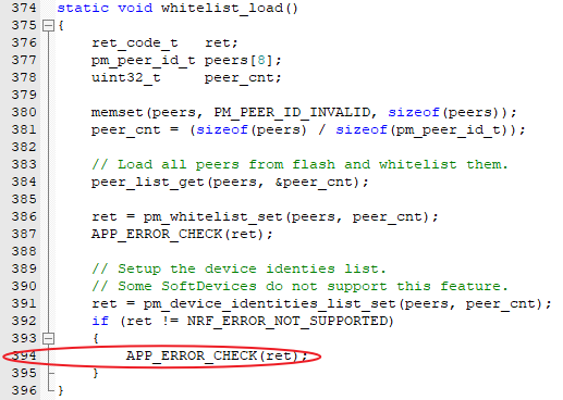

I'm using whitelist when bonded, but I want delete bonded then connect to anther device,.

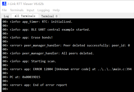

But when scan again, whitelist_load is error. Try delete whitelist at the same time, The error still exists.

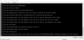

I found no entry PM_EVT_PEERS_DELETE_SUCCEEDED of pm_evt_handler. So I change below code replace, another error is appear.
"<warning> peer_manager_gcm: CAR char value couldn't be stored (error: NRF_ERROR_INVALID_PARAM). Reattempt will happen on the next connection."
