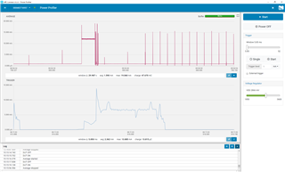

    Yes, see this post. Note that the HFCLK and UART peripheral will be running all the time in CLI, meaning you will not get very low current consumption.
    These CLI commands should work for SED:
    > panid 0xabcd
    Done
    > ifconfig up
    Done
    > thread start
    Done
    > mode n
    Done
    > pollperiod 1000
    Done
    This gives me the following current consumption:
    sivaguru said:
    If a node get reset in cli , when it start again , it need to scan and have to get commissioned again to rejoin the mesh again right , in hand shaking mode
    No, you only need to set the PANID the first time and bring up the interfaces after each reset. The example is pre-commissioned.
