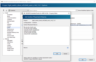

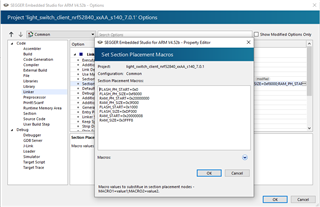

- took the project: nrf5_SDK_for_Mesh_v4.0.0_src\examples\light_switch\client\light_switch_client_nrf52840_xxAA_s140_7_0_1
- changed the settings of preprocessor definitions in board-type from PCA10056 -> PCA10059
- changed the settings of Preprocessor -> Linker -> placementMacros ... addresses like in attached screenshots
addresses_DKaddresses_Dongle

    1) I want to run the client-mesh from DK sources into Dongle.
    So, I did:
    - modified the client-dk project: nrf5_SDK_for_Mesh_v4.0.0_src\examples\light_switch_dongle\client by:
    a) changing the settings of preprocessor definitions in board PCA10056 -> PCA10059.
    b) I also changed the memory addresses: Preprocessor -> Linker -> Section Placement Macros ->
    FLASH_PH_START=0x0
    FLASH_PH_SIZE=0x100000
    RAM_PH_START=0x20000000
    RAM_PH_SIZE=0x40000
    FLASH_START=0x27000
    FLASH_SIZE=0xd9000
    RAM_START=0x20002300
    RAM_SIZE=0x3dd00
