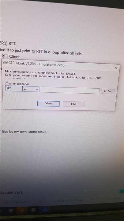

I'm trying to get the Thingy device work with (SEGGER's) RTT.
I used the asset_tracker sample application and edited it to just print to RTT in a loop after all inits.
Sadly, printing to RTT never outputs anything on the RTT Client.

To receive RTT msgs i used JlinkExe (connected), and JLinkRTTClient.
Please help me understand why I don't get any output.
