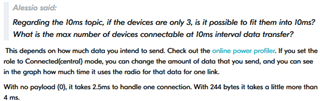

    Regarding the 10ms topic, if the devices are only 3, is it possible to fit them into 10ms? What is the max number of devices connectable at 10ms interval data transfer?
     This depends on how much data you intend to send. Check out the online power profiler. If you set the role to Connected(central) mode, you can change the amount of data that you send, and you can see in the graph how much time it uses the radio for that data for one link.
    With no payload (0), it takes 2.5ms to handle one connection. With 244 bytes it takes a little more than 4 ms.

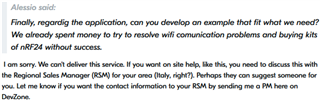

    Finally, regardig the application, can you develop an example that fit what we need? We already spent money to try to resolve wifi comunication problems and buying kits of nRF24 without success.
     I am sorry. We can't deliver this service. If you want on site help, like this, you need to discuss this with the Regional Sales Manager (RSM) for your area (Italy, right?). Perhaps they can suggest someone for you. Let me know if you want the contact information to your RSM by sending me a PM here on DevZone.
