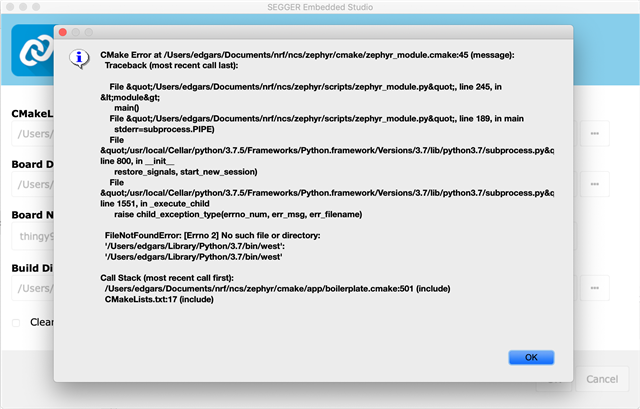

I am setting up SEGGER on my mac. Completed all the steps in Getting Started Assistant.

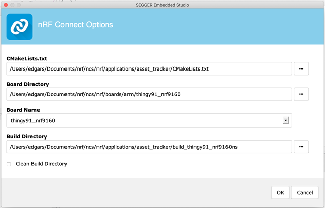

But in the last step at "Set up a project in SEGGER Embedded Studio" where I need to set locations for files and directories, after I press OK, I get an error.
These are the locations
After pressing OK

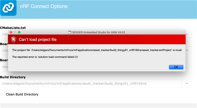

And after that
If I try to do it once more without changing anything I get
and again this afterwards
From this I understand, that it is looking for python files in user folder, but by default they are in system folder. How do I chance location where it looks for it?

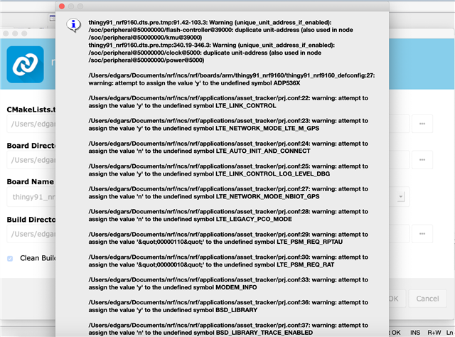

Also here is the full list of problems from first error screen
thingy91_nrf9160.dts.pre.tmp:91.42-103.3: Warning (unique_unit_address_if_enabled): /soc/peripheral@50000000/flash-controller@39000: duplicate unit-address (also used in node /soc/peripheral@50000000/kmu@39000)
thingy91_nrf9160.dts.pre.tmp:340.19-346.3: Warning (unique_unit_address_if_enabled): /soc/peripheral@50000000/clock@5000: duplicate unit-address (also used in node /soc/peripheral@50000000/power@5000)
/Users/edgars/Documents/nrf/ncs/nrf/boards/arm/thingy91_nrf9160/thingy91_nrf9160_defconfig:27: warning: attempt to assign the value 'y' to the undefined symbol ADP536X
/Users/edgars/Documents/nrf/ncs/nrf/applications/asset_tracker/prj.conf:22: warning: attempt to assign the value 'y' to the undefined symbol LTE_LINK_CONTROL
/Users/edgars/Documents/nrf/ncs/nrf/applications/asset_tracker/prj.conf:23: warning: attempt to assign the value 'y' to the undefined symbol LTE_NETWORK_MODE_LTE_M_GPS
/Users/edgars/Documents/nrf/ncs/nrf/applications/asset_tracker/prj.conf:24: warning: attempt to assign the value 'n' to the undefined symbol LTE_AUTO_INIT_AND_CONNECT
/Users/edgars/Documents/nrf/ncs/nrf/applications/asset_tracker/prj.conf:25: warning: attempt to assign the value 'y' to the undefined symbol LTE_LINK_CONTROL_LOG_LEVEL_DBG
/Users/edgars/Documents/nrf/ncs/nrf/applications/asset_tracker/prj.conf:27: warning: attempt to assign the value 'n' to the undefined symbol LTE_NETWORK_MODE_NBIOT_GPS
/Users/edgars/Documents/nrf/ncs/nrf/applications/asset_tracker/prj.conf:28: warning: attempt to assign the value 'n' to the undefined symbol LTE_LEGACY_PCO_MODE
/Users/edgars/Documents/nrf/ncs/nrf/applications/asset_tracker/prj.conf:29: warning: attempt to assign the value '"00000110"' to the undefined symbol LTE_PSM_REQ_RPTAU
/Users/edgars/Documents/nrf/ncs/nrf/applications/asset_tracker/prj.conf:30: warning: attempt to assign the value '"00000010"' to the undefined symbol LTE_PSM_REQ_RAT
/Users/edgars/Documents/nrf/ncs/nrf/applications/asset_tracker/prj.conf:33: warning: attempt to assign the value 'y' to the undefined symbol MODEM_INFO
/Users/edgars/Documents/nrf/ncs/nrf/applications/asset_tracker/prj.conf:36: warning: attempt to assign the value 'y' to the undefined symbol BSD_LIBRARY
/Users/edgars/Documents/nrf/ncs/nrf/applications/asset_tracker/prj.conf:37: warning: attempt to assign the value 'n' to the undefined symbol BSD_LIBRARY_TRACE_ENABLED
/Users/edgars/Documents/nrf/ncs/nrf/applications/asset_tracker/prj.conf:40: warning: attempt to assign the value 'y' to the undefined symbol CLOUD_API
/Users/edgars/Documents/nrf/ncs/nrf/applications/asset_tracker/prj.conf:41: warning: attempt to assign the value 'y' to the undefined symbol NRF_CLOUD
/Users/edgars/Documents/nrf/ncs/nrf/applications/asset_tracker/prj.conf:42: warning: attempt to assign the value 'y' to the undefined symbol NRF_CLOUD_LOG_LEVEL_DBG
/Users/edgars/Documents/nrf/ncs/nrf/applications/asset_tracker/prj.conf:43: warning: attempt to assign the value 'y' to the undefined symbol NRF_CLOUD_AGPS
/Users/edgars/Documents/nrf/ncs/nrf/applications/asset_tracker/prj.conf:44: warning: attempt to assign the value 'y' to the undefined symbol NRF_CLOUD_CONNECTION_POLL_THREAD
/Users/edgars/Documents/nrf/ncs/nrf/applications/asset_tracker/prj.conf:46: warning: attempt to assign the value 'y' to the undefined symbol CJSON_LIB
/Users/edgars/Documents/nrf/ncs/nrf/applications/asset_tracker/prj.conf:50: warning: attempt to assign the value 'y' to the undefined symbol CLOUD_PERSISTENT_SESSIONS
/Users/edgars/Documents/nrf/ncs/nrf/applications/asset_tracker/prj.conf:58: warning: attempt to assign the value 'y' to the undefined symbol NRF9160_GPS
/Users/edgars/Documents/nrf/ncs/nrf/applications/asset_tracker/prj.conf:60: warning: attempt to assign the value 'y' to the undefined symbol NRF9160_GPS_LOG_LEVEL_DBG
/Users/edgars/Documents/nrf/ncs/nrf/applications/asset_tracker/prj.conf:71: warning: attempt to assign the value 'y' to the undefined symbol DK_LIBRARY
/Users/edgars/Documents/nrf/ncs/nrf/applications/asset_tracker/prj.conf:72: warning: attempt to assign the value 'n' to the undefined symbol DK_LIBRARY_INVERT_LEDS
/Users/edgars/Documents/nrf/ncs/nrf/applications/asset_tracker/prj.conf:95: warning: attempt to assign the value 'y' to the undefined symbol AWS_FOTA
/Users/edgars/Documents/nrf/ncs/nrf/applications/asset_tracker/prj.conf:96: warning: attempt to assign the value 'y' to the undefined symbol FOTA_DOWNLOAD
/Users/edgars/Documents/nrf/ncs/nrf/applications/asset_tracker/prj.conf:97: warning: attempt to assign the value 'y' to the undefined symbol AWS_FOTA_LOG_LEVEL_DBG
/Users/edgars/Documents/nrf/ncs/nrf/applications/asset_tracker/prj.conf:98: warning: attempt to assign the value 'y' to the undefined symbol AWS_JOBS_LOG_LEVEL_DBG
/Users/edgars/Documents/nrf/ncs/nrf/applications/asset_tracker/prj.conf:99: warning: attempt to assign the value 'y' to the undefined symbol DFU_TARGET
/Users/edgars/Documents/nrf/ncs/nrf/applications/asset_tracker/prj.conf:102: warning: attempt to assign the value 'y' to the undefined symbol DOWNLOAD_CLIENT
/Users/edgars/Documents/nrf/ncs/nrf/applications/asset_tracker/prj.conf:103: warning: attempt to assign the value '4096' to the undefined symbol DOWNLOAD_CLIENT_STACK_SIZE
/Users/edgars/Documents/nrf/ncs/nrf/applications/asset_tracker/prj.conf:106: warning: attempt to assign the value 'n' to the undefined symbol RESET_ON_FATAL_ERROR
error: Aborting due to Kconfig warnings
CMake Error at /Users/edgars/Documents/nrf/ncs/zephyr/cmake/kconfig.cmake:217 (message):
  /Users/edgars/Documents/nrf/ncs/zephyr/cmake/app/boilerplate.cmake:504 (include)
  CMakeLists.txt:17 (include)
Please help me understand where the problem is and finish the setup.

  • Check the comment in NCS tutorial part 1 - nRF9160 DK:
    "The modem always operates in a non-secure domain (read more about this in External domain access control on the infocenter), and the application must do the same in order to communicate with it. Therefore, all the samples in <..>/nrf/samples/nrf9160 as well as the asset_tracker, have to be built as nonsecure in order to work."
    Therefore, you have to choose the nonsecure version of the board in the nRF Connect Options. Set Board name equal to thingy91_nrf9160ns instead of thingy91_nrf9160.
    Simon
  • I know that, I tried both. But it doesn't change anything regarding to my problem.
  • Hi Edgar!
    Sorry to jump in, but I have struggled a lot before finally getting SES to work reliably in macOS (especially Catalina) before finally trying python virtual environments. The only(?) caveat is that you have to start SES from a terminal.
    Since I had made a lot of failed attempts at getting things to work, I started with a complete uninstall of HomeBrew. Then, I basically followed the instructions in the nrFConnect Getting Started Assistant with the following additions (not sure how important each step is, but the end result is good):
    1. After extracting the GNU ARM Embedded tar to /opt/gnuarmemb, install the nRF Command-Line Tools (nRF Tools and J_LINK).
    2. After installing west and cloning the repos to the ncs folder of my choice, in the terminal:
    a. Create a Python virtual environment: python3 -m venv Path/To/ncs120 (or whatever folder name you choose)
    b. Activate the Python virtual environment: source path/to/ncs120/bin/activate
    3. Then, still in the terminal, install the required Python modules:
    a. pip3 install -r zephyr/scripts/requirements.txt
    b. pip3 install -r nrf/scripts/requirements.txt
    c. pip3 install -r bootloader/mcuboot/scripts/requirements.txt
    After extracting the SES to /Applications/Path/To/SES (or whatever folder name you choose) start SES as follows:
    A. Open a terminal
    B. Activate the Python virtual environment: 'source path/to/ncs120/bin/activate'
    C. Start SES: "/Applications/PathTo/SES/Segger Embedded Studio for ARM 4.52.app/Contents/MacOS/emStudio"
    Ensure the correct paths in your .bashrc/.zshrc file:
    export PATH="$HOME/Library/Python/3.7/bin:$PATH"
    export PATH="/Applications/Nordic Semiconductor/nrfjprog:$PATH"
    export PATH="/Applications/Nordic Semiconductor/mergehex:$PATH"
    export ZEPHYR_TOOLCHAIN_VARIANT=gnuarmemb
    export GNUARMEMB_TOOLCHAIN_PATH=/opt/gnuarmemb
    export ZEPHYR_BASE=/Volumes/MacData/Users/pemar/Develop/Nordic/ncs/zephyr
    source /Volumes/MacData/Users/pemar/Develop/Nordic/ncs/zephyr/zephyr-env.sh
    Ensure that the SES Options for RF Connect CMake and Executable are set to None; the Directories for ARM Embedded Toolchainand Zephyr Base must be set correctly
    One "bonus" is that you can start multiple instances of SES by repeating the steps A-C from a new terminal window.
    I hope I didn't miss anything. Good luck!
    /Per
