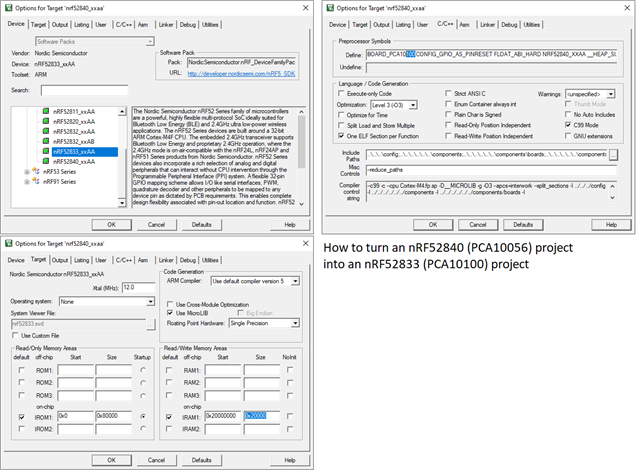

I´m trying to work with the "TWI Scanner" example, provided by SDK 16. I Use nRF52833 DK (PCA10010), unfortunaly there is no solution for PCA 10010 in the SDK. This is why I flashed PCA10040 to my nRF52833 DK.
And I got the message "TWI scanner started." from UART terminal, so I think the example also works on nRF52833 DK.

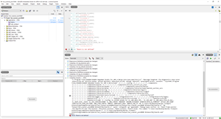

So, I´ve done just one modification to the example: I change SCL and SDA Pin to 33 and 34 (P1.02 and P1.03 of nRF52833 DK) as shown in screenshot attached (here I´m not sure with!).
