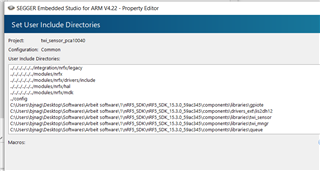

    i strated from beginning in new SDK folder, and have changed the path as you mentioned.
    I copied and created a custom twi sensor folder.
    Copied the main.c file.
    add .c files
    add .h files
    Replaced the flash_placement file
    add below code in sdk_config
    #ifndef NRF_TWI_MNGR_ENABLED
    #define NRF_TWI_MNGR_ENABLED 1
    #ifndef NRF_QUEUE_ENABLED
    #define NRF_QUEUE_ENABLED 1
    1. should the twi manager be enabled , below is the snapshot of how it looks.
    If this needs to be enabled. How to do so?

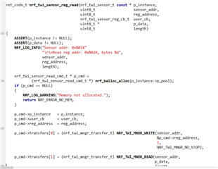

    <warning> twi_sensor: Memory not allocated.
    <error> app: Fatal error
    How to resolve this?
  • You need to enable it in sdk_config.h:
    // <q> NRF_TWI_MNGR_ENABLED  - nrf_twi_mngr - TWI transaction manager
  • As you can see in the steps i have followed, i have included this in the sdk_config. But still i face the problem. Can you explain in detail the steps, you followed . Because the control doesnt enter the function print_identity with my code and current settings.
  • If you do not get any compilation errors, the library is either not used, or it is compiled correctly. SES sometimes does not update the GUI unless you close and reopen the file, it may look grayed out even if it is included. Are you calling the functions from twi_mngr in the application?
  • Im not getting any compilation error. and as you said, the greyed out area issue is now resolved. But i see no change in the output.

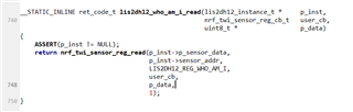

    In the lis2dh12_internal.h , this function is called

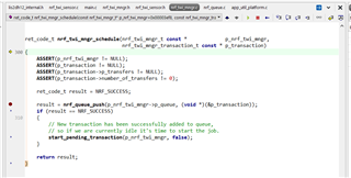

    After which inside the twi_sensor.c , the following loop is getting executed, the result of log is printed,
    and as you can see, there are function to goto twi_mngr,

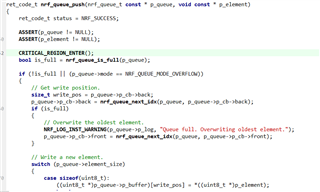

    The loop goes into nrf_mngr_schedule, from there to nrf queue as below
    nrf_queue_push gets executed and it comes out of loop
    into main, and prints.
