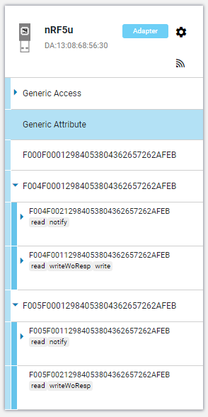

I created a "custom base-uuid" for my services and charactersitics.
Here is a screenshot of my server config while advertising:

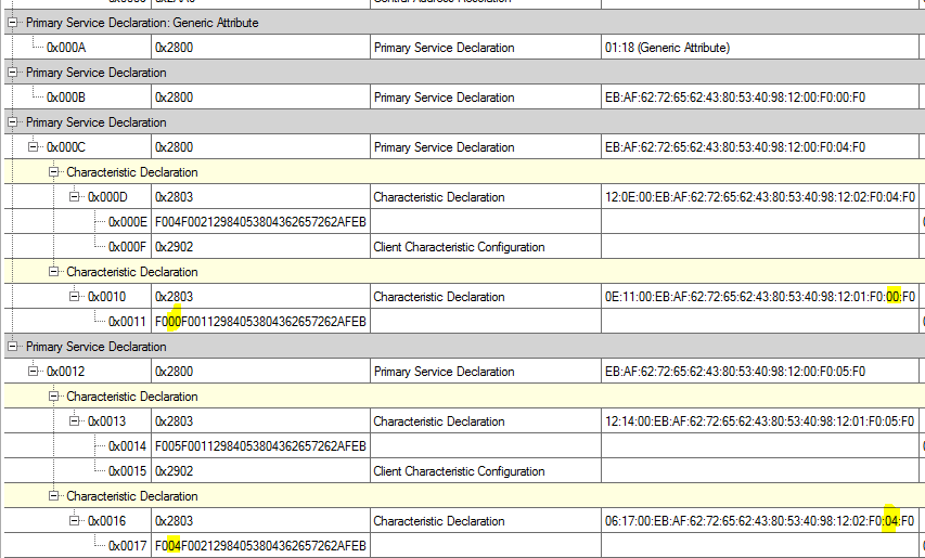

But when I connect to the dongle and do a discovery, I get different/broken UUIDs. Actually, every first characteristic in a service is OK, but the other ones are broken.
Strange thing also: the UUID in Handle 0x0017 should be in the other Service @Handle 0x000C! (F004F000... instead F005F000...)

    To me, all this looks a bit strange, because this is typically not where you insert the characteristic specific UUID. Usually it is byte 3 and 4 that are characteristic specific, and not byte 2.
