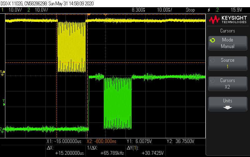

I have on my custom board 2 spi , spi1 and spi3.
&spi3 {
status = "okay";
sck-pin = <31>;
mosi-pin = <9>;
miso-pin = <30>;
cs-gpios = <&gpio0 26 1>,<&gpio0 15 1>;
&spi1 {
status = "okay";
sck-pin = <3>;
mosi-pin = <8>;
miso-pin = <5>;
cs-gpios = <&gpio0 4 1>;
The spi works within an interrupt and spi3 works fine with 2 slaves.

 Routiunes SPI_read_continuous(0x2a,2); , MT25qlxx_WriteEnable(); , MT25qlxx_WriteFullPage(&flash_buffer[flash_bank][flash_section_counter * 0x100],0);
SPI_read_continuous(0x2a,2);    works with spi3  1st cs,
 MT25qlxx_WriteFullPage(&flash_buffer[flash_bank][flash_section_counter * 0x100],0);   works with spi3  2nd cs,
ReadAccelerometerXYZ(); works with spi1.
As long as only one spi works 1 or 3 , The spi works fine ,  ( I comment out the unrelated spi call ).
When the 2 spi works 1 and 3 , The system is stuck after the first interrupt .
The Interrupt occurs every 2 mSec , there is no time overflow .
What can cause this phenomena ?
Attached a scree shot , the top is spi3 , the bottom is spi1 , after 1 interrupt the system is stuck
Please Advise.
