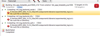

I have the fail complie sample project the same picture.I try found experimental_log in libraries but it not found.Pls kindly help me!Thank,

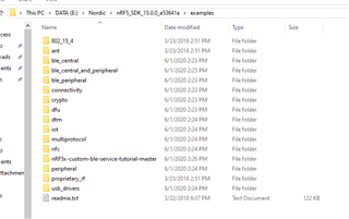

So have you checked whether that file and/or that directory do actually exist on your system?
A common problem -not specific to Nordic - is when Projects reference files via relative paths: for this to work, you have to have the project in the correct relative location to those other files.
So you should also check whether that file and/or that directory exists at a (slightly) higher/lower lever in the folder tree on your system...

You mean this: https://devzone.nordicsemi.com/nordic/short-range-guides/b/bluetooth-low-energy/posts/ble-characteristics-a-beginners-tutorial ?
Note that it does say specifically nRF5_SDK_v15.x.x - so are you using that version?
ok i have fixed it.Thank your support!

First you should use SDK15.0.0
Seconly,put sample as blow picture
