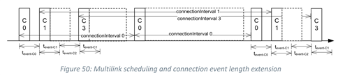

It is also worthwhile to understand that there is nothing ideal in this world, so situations are possible when the device cannot transmit data. Therefore, damping of data is provided before sending, followed by catch-up. Based on this, it will be more optimal to select the value of the GAP_CONNECTION_EVENT equal to 10. And allow the option to expand the connection interval. Then with more data available, I can get a picture roughly similar to this one from the specification:

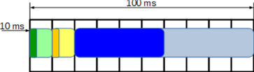

More precisely for my case, this picture should look like this:
Where dark color indicates the transmission of data in a normal situation and the lightest possible time to extend the interval.

Q1. Obviously, to ensure the planned value of the data flow, the connection sequence is necessary, as indicated in the figure. Otherwise, a device with a large amount of data will not have enough time to transfer data. Is redundancy manual positioning of connections possible?
Q2. If not, then at the application level, you can try to start in the correct sequence. BUT: if a device or two were turned off and then back on, how will the scheduler behave? Will he insert a new connection into an arbitrary place? That is, how to avoid, for example, such a situation:
Q3. Regarding the choice of the duration of the connection event: should this value be the same for both the master and the slave? The MTU setting affects, as the values are matched. and here?
