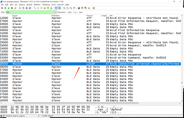

I am using SDK16.0(ble_app_uart) program to sending dates between the phone and board.And I noticed that send function (ble_nus_data_send)failed a few times when it didn't go in.
Normal delivery process
The wrong sending process
sniffer package

Hi Roy,
Seems that you created the sniffer trace from a very old Wireshark version, I couldn't open it using Wireshark v3.2.1
Which sniffer firmware did you use ? I would suggest to use our latest sniffer v3.0.0
In your screenshots, I can see that you were pointing to Malformed packets, could you tell us the difference ? If it's a CRC invalid packet, it will just be ignored by the softdevice.
