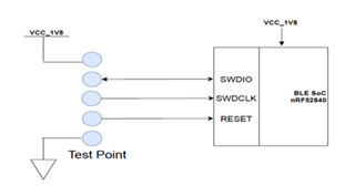

We are working on NRF52840, and we gave 1.8 V to power on, so please confirm can we flash/program it on 1.8 v or not?
I can confirm that it supports programming at 1.8 Volts. But make sure your programmer supports this target voltage as well. Some programmers are limited to a fixed voltage (no built-in level shifter).
